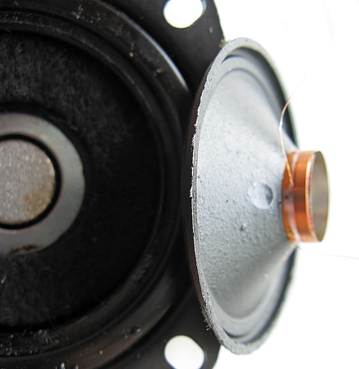

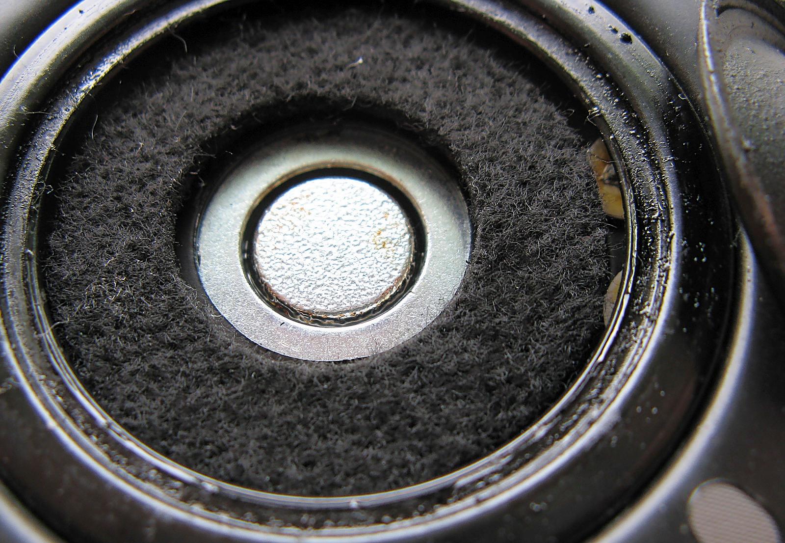

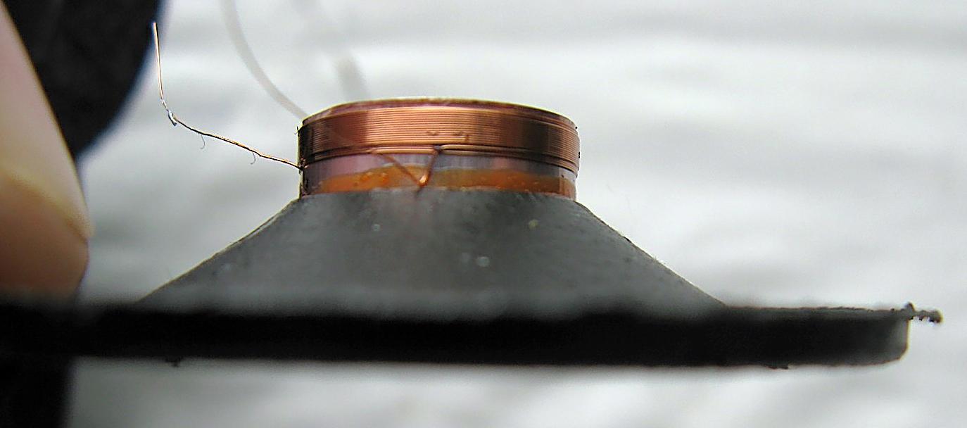

Ok, here we go. Some photos of the inside of the tweeter. I can't take anymore as I've thrown the sample out. I'll be updating this thread with the internal findings and assessment.

CT62 i said to be oil damped. Where is the oil?
Re: A Look Inside the CT-62 Tweeter
Yes, where is it?

To put any anxieties to rest, the ferrofluid is there alright, you can just make out some residue around
the polepiece in the one picture. I should've taken a shot of a slip of white paper wicking it up out of the gap.
Simply put, would I trade this tweeter for a Matsu? Not hardly. The CT-62 measured relatively smoothly
in terms of frequency response (as previously mentioned in the now defunct Matsu tweeter for sale
ad).
Others may have taken these apart before to see what's inside but like on the vast majority of audio
based internet forums, I've noticed members have little experience in driver design pragmatics and
therefore don't know how to observe precisely in detail what it is they are looking at. I do.
Some CT-62 design observations based upon experience;
It has a one piece formed poly diaphragm (which includes dust cap) with *very* slight curvature and
circumferential edge crimp.
Ferrofluid is present
Magnet is ceramic (not rare earth by any stretch).
The former used is aluminum and wrapped with round wire.
The pole piece is straightsided (i.e. non-focused geometry)
No inductance control is used.
The felt ring is not glued to the inside of the basket (it can flop around in there) with no
indication of adhesive residue for retention.
The sealed rear chamber is a relatively good size.
The tweeter does not use a spider to centre the coil. The stamped basket is a two piece press fit. The
combination of this and ferrofluid centres and maintains coil alignment in the gap in lieu of a
spider.
The adhesive used to attach the former to diaphragm is solvent tolerant (i.e. soft).
You think the published technical data is going to provide all those extra manufacturing design
details? It requires someone with experience who knows how drivers are put together and what makes
them sound the way they do. I won't bore the reader by going into the details but the above considerations are relevant.
When you have to obey all the laws of physics all of the time, the devil lies in the details.
Here is something only people who really know what they're talking about know. Notice the
voicecoil leads? Based on that glaring hint, let's see if a reader can determine another thing which makes the CT-62
a slightly cheaper tweeter than what it could have been.
As a final, take notice of the small divit on the back side of the cone. This is from a hot drop of
solder while taking the unit apart. Poly is not tolerant of heat. Imagine if your voicecoil heats up under high load?
I've seen poly go into meltdown at the former joint due to heat stress.
The CT-62 is not a super cheap tweeter, but not beautifully made either. But hey, that's business and
the bottom line. I commend the Peerless engineers for getting a product out there which not only does the job and
makes their bosses money too.
As for vintage audio, it's largely about getting the best and rarest for closest to free
as possible (and then of course bragging about it in an internet audio forum ;> ).
Given the chance, if the CT-62 were still made they'd outsell this new OBI(?) tweeter 10:1
due to price differential and we all know it.
