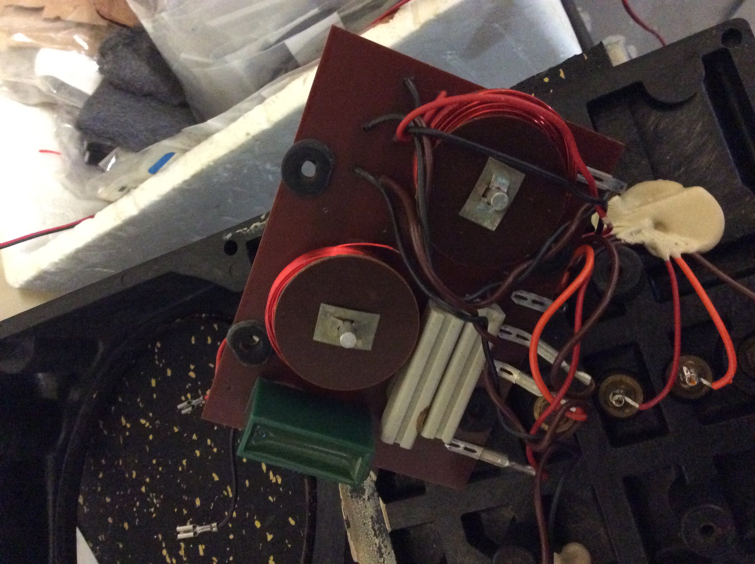

Hi all sonab experts I'm currently restoring a pair of sonab oa-12 and to my surprise I've noticed a different crossover fitted. I'm certain these are original and never tampered with no evidence of anyone soldering or removing them before me. There is no 10uf capacitor just a 5.6uf has anyone come across this before? There's two coils and two resistors I'm curious if sonab changed the design throughout the sonab oa-12 lifecycle??? I've had about six pairs of oa-12 and this is the first time I've seen this. Welcome anyone experience here!

At first for a brief period there was a filter that was asymmetric.
That filter was in production for only a brief time.
I world rekommenderar to uppgrade the filter to the newer version.

Thankyou! Do you know if the coils are the same? They aren't labelled

I have finally found my scribbled notes on the old crossover!
Woofer: Coil 0.64 mH.
Tweeters: Capacitor 5,6uF and Coil 0,54 mH, drivers connected in reverse polarity. Reistors both 2,2 Ohms.
I hope this helps
Best regards
