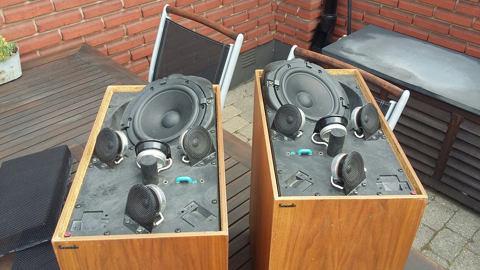

I am about to undertake another OA-12 upgrade project; this time using the Satori mid-woofer, Obi T22 tweeters, and filter by grafpro. Parts are ordered.
I was visiting #2 son in Montana a couple weeks ago. He has the pair I upgraded 6 years ago, with Carlsson B65 drivers. Paired with the old Pioneer SX-750 receiver I gave him (which I had since new in 1976), it remains one of the sweetest sounding combinations I have ever heard - so I am excited to hear what the Satori upgrade will do! It took me a long time to get around to it.

1. The Satori driver has 6 screw holes around a thick cast rim instead of the turned up steel rim of the original drivers, which accepts 4 retainer clips. How do you mount the Satori drivers? Do you clamp the rim with the 4 original retainer clips, or do you drill and screw using the 6 screw holes in the Satori driver?
Appreciate any guidance. I'm sure I will have more questions as I go along.
Appreciate any guidance. If anybody has photos that'd be great too. I'm sure I will have more questions as I go along.
Re: Sonab OA-12 upgrade
I have used the original retainer clips but without the rubber pieces. This way there are no extra holes drilled.

STDI! Thank you! That's how I was hoping it would work. Wasn't looking forward to drilling a bunch of holes in my immaculate old speakers.

Just reporting in that the upgrade is complete, and I am delighted with how they sound!
