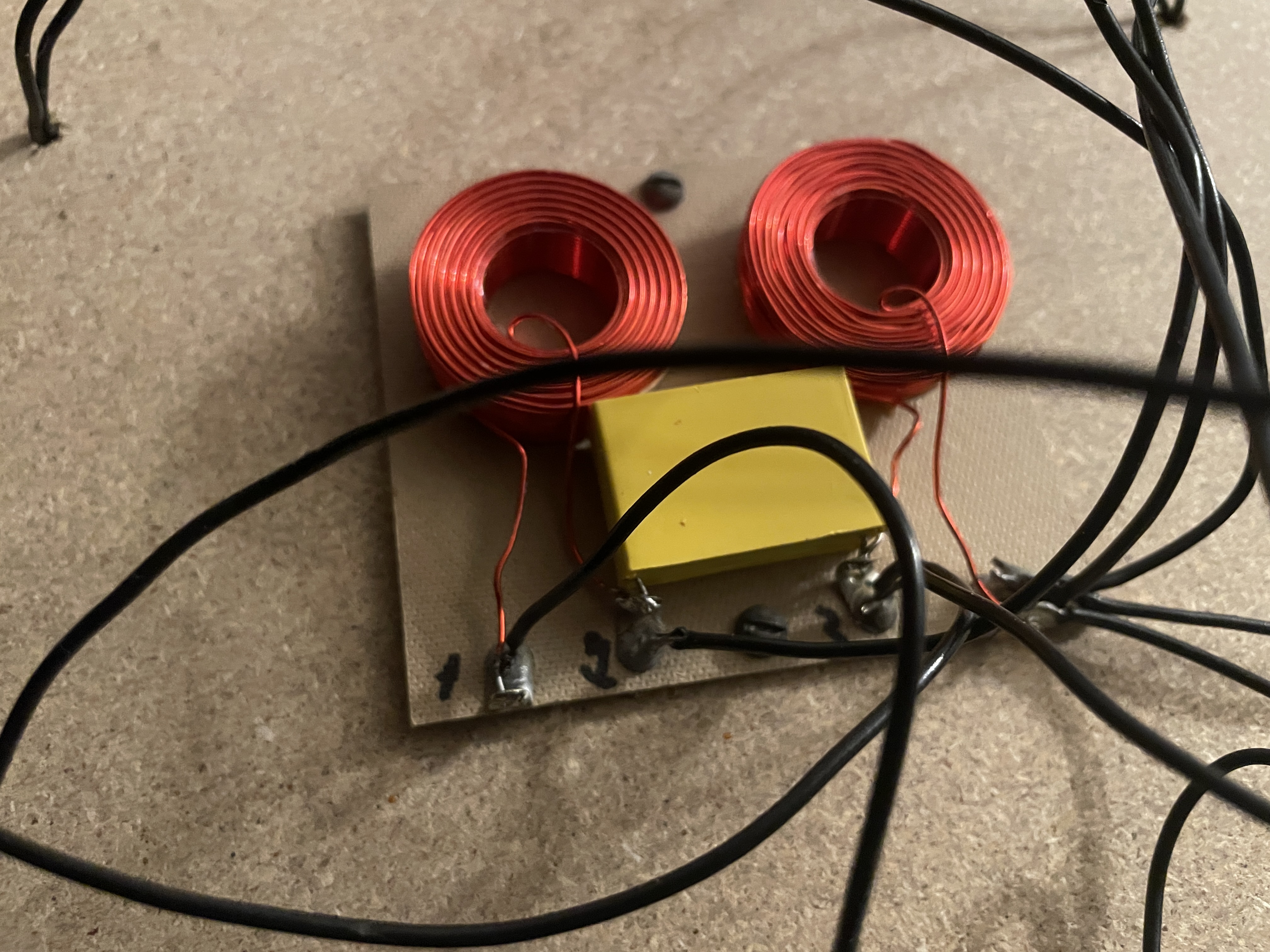

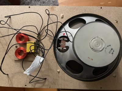

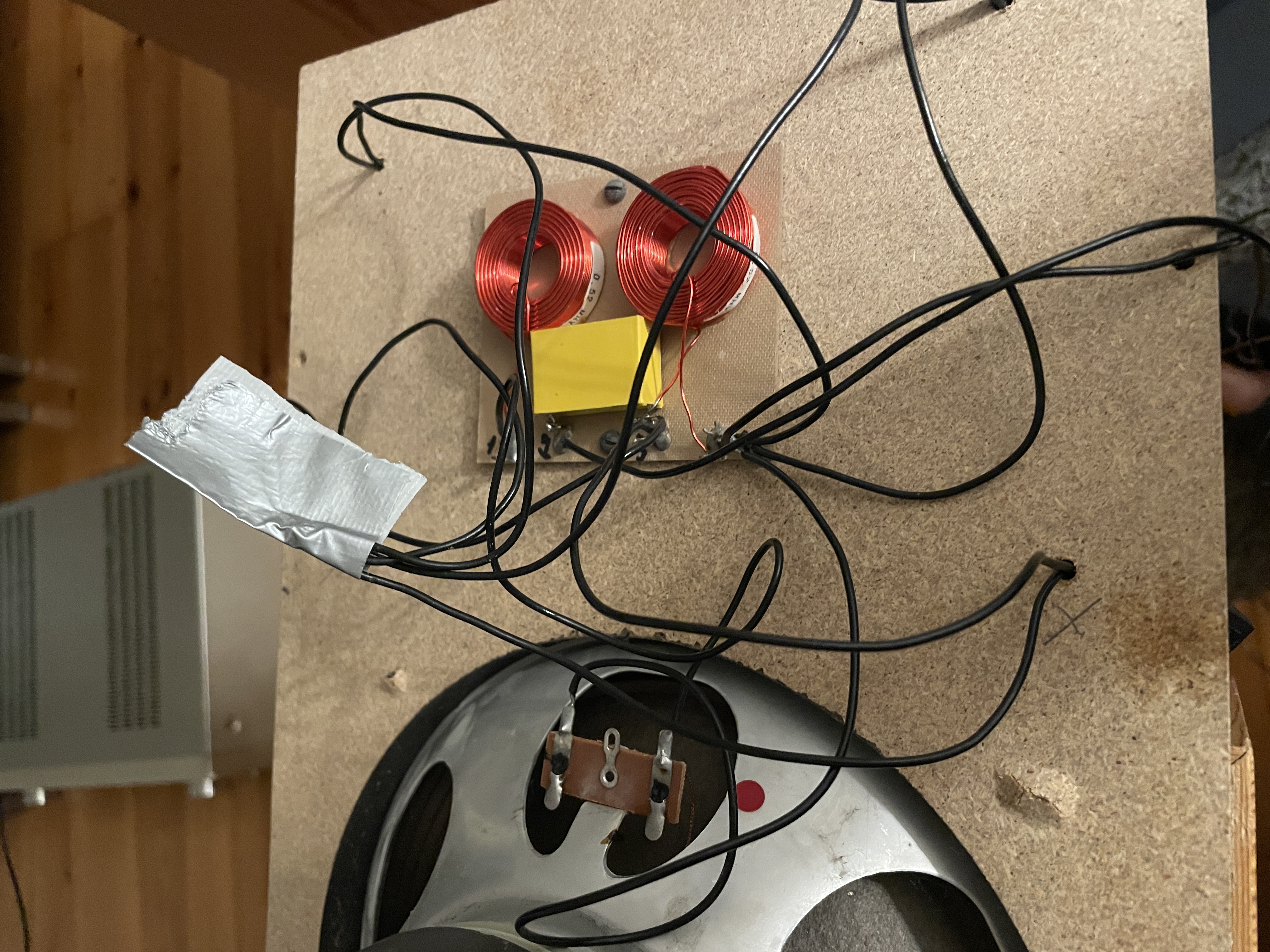

I have the strangest issue I can't figure out - one of the speakers only plays upside down. I checked the wiring and compared to the working speaker, and I can't find the issue. Around 90 degrees it cuts out, but works again when turned upside down once again.
This has me thinking it's a gravity issue, but all connections are clean and happy.
Anyone heard of an issue like this before?
