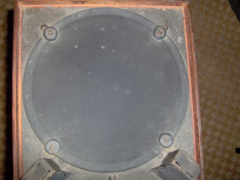

I've cleaned these speakers about half a year ago. They were completely dust free again. I just took a close look, and guess what? There's already a thick layer of dust on them again. After quickly whiping the worst off, I could see the screws holding the baffle on it's placed. I always thought that they were glued, but I'm so happy they aren't. I'll take a look tomorrow to see if it comes off easily.
So if I'm right, I can touch the screws with those rubber damping thingy's on them? These are holding the woofer in it's place. There are (I think three) small screws around the woofer, I can't touch them?

Included are three pictures of my speakers, so now you know what they look like. The first one is a closeup from the woofer, the second one represents the overal condition of the tweeters (they don't look so good, I know) and the third one gives you a good impression about how the cabinet looks. It's scratched a bit, but that's something that can be easily fixed, and I don't really care about that at the moment.
- One of the woofers. It's a bit dusty, I'm going to clean them, as described on the page, first thing tomorrow.

Hi
You´ve got it right about the screws.
