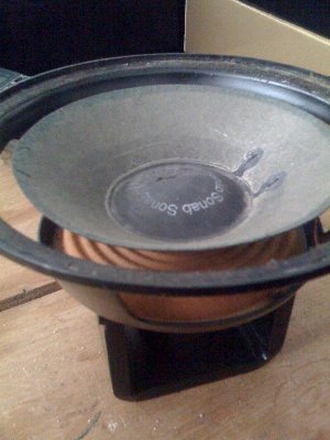

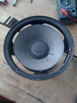

So one of the speakers arrived the other day (other one is being held for import taxes unfortunately), I've had a look inside - everything is just push-on terminals (i.e. no soldering) so I don't know why the oa-116 page has all these scary warnings about how difficult it all is? Seems to me the difficulty is all in the re-foaming, but the speakers themselves seem very easy to open/change parts..
In any case, I've removed the mid range element and cleaned off most of the old foam, but some of the glue still remains (no hurry, I'm waiting for new surrounds to arrive).
Thing is, I'm no expert at this and quite worried I might do something wrong - even if only a little bit wrong, and end up with working speakers but not quite the sound it should be :\

So I've done the re-foaming via the battery method - seemed easier than I thought, but as it turned out I ended up getting two of them a bit wrong (I think they started off centered just right, but the way I left them to dry with some pressure on top the foam must have moved a bit). Used the method of pulling the cone away from the direction where it rubs in the air gap to try to fix it (in one case with the glue still setting, the other I basically had to stretch the foam a bit), it's sort of worked in that there's no more scraping, but one side does seem to be generating distinctly less bass than the other :? (and the bass element in that side was the one where I had to stretch the foam, so I think what they say about lower efficiency if it's not perfectly centred may just be true..)
For now I think I'll just listen to them for a bit, just because it's taken quite a long time to get to this stage, but seems likely I'll be ordering another kit at some point.
Also have what seems to be two blown tweeters - this is just by trying to listen with my ear up against each one - quite difficult to be sure unfortunately. EDIT: checked more carefully with some pink noise - one is definitely not making any sound, but the same one on the opposite speaker seems quieter than the others - does anyone know if the two closest to the listening position (pointing towards the wall between the speakers) are supposed to be quieter? I checked the DC resistance but it seems they're all between 2.7 and 3.2 ohms / not really sure what's the next step?
