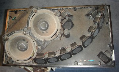

The 2212's are now somewhere in the Alps! but here is a pic supplied by the seller to make your eyes water :shock:
Regards Andy
