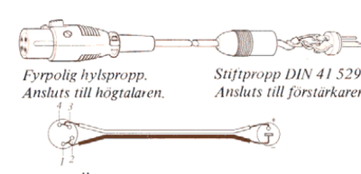

I can do either, that is, use the existing xlr 4 pin connectors or change to new posts with banana plug option. However I still have a question about the four wires that run to the speaker xlr connector. I will probably have to custom make xlr speaker cables, and it will need to terminate in two wires. So do I short the two "-" and two "+" in order to arrive at 2 wires at the amplifier? Similarly, to install new binding posts I would have to solder two wires to one post, and the same to the second post. Is that correct?
Re: OA-2212 XLR connectors
The picture shows the speaker cable female XLR (not male as I first wrote in my answer yesterday). Pin 1 and 2 (they are numbered in the XLR-contact) are shorted and goes to amplifiers minus. Pin 3 and 4 are shorted and goes to amplifiers plus. So it's easy to make a new cable if you buy two 4-pin XLR female contacts.
Inside the speaker the XLR pins are all separated but if you want to use new speaker terminals you short pin 1 and 2 wires to the minus terminal and pin 3 and 4 wires to plus terminal.

Yeas.that`s the trick. 8-)
Transforme 4 wires into 2.
Connect left speaker with 2 wires(1 plus and 1 minus) to left speaker connections on the amplifier 1 marked plus(red) and 1 marked minus(black).
Connect right speaker with 2 wires(1 plus and 1 minus) to right speaker connections on the amplifier 1 marked plus(red) and 1 minus(black).
