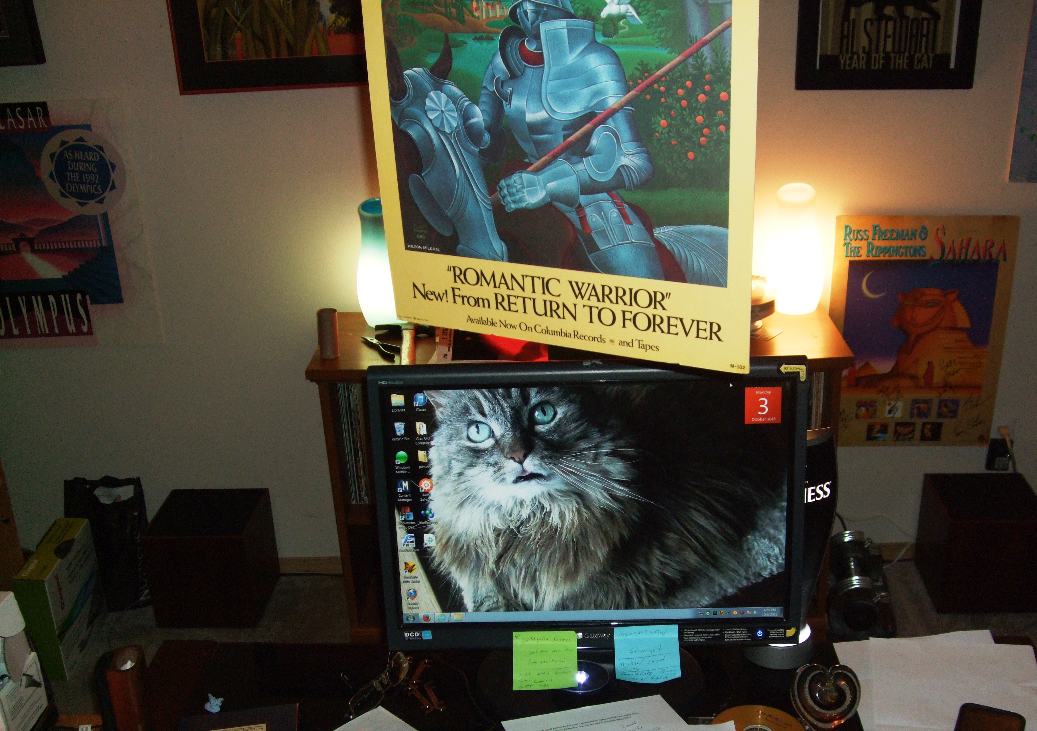

So, moved a whole bunch of stuff around to try these on the floor. Much much better. here is a pic showing what I am fighting sound wise in my computer room...:)
computer room set up
