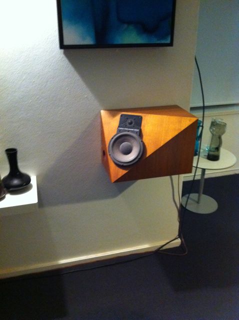

Thanks Martin. Does anyone have a picture of a pair of OA51LE2 with the later model absorbers that attach on the back?

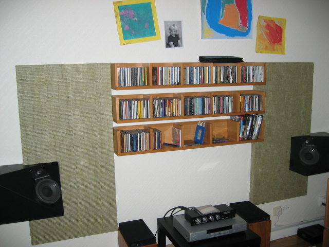

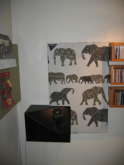

Those "elefantöron" (the elephant ears) are DIY. They were suggested in the patent, but I do not think they were produced or sold. Here are some examples of how they can be made:
Use 45-50 mm thick mineral wool for thermal insulation.
The speakers should be right up with their backs against the wall. Just make a suitable cut-out in the mineral wool. Dress it with some textile that let the sound pass.
Roger

Hi Julian!
I think this picture shows you what the present absorbents that you can purchase from Larsen HiFi (same as the OA 51 LE2 kit) looks like.
http://user.faktiskt.se/naqref/carlsson/OA51_3.jpg
