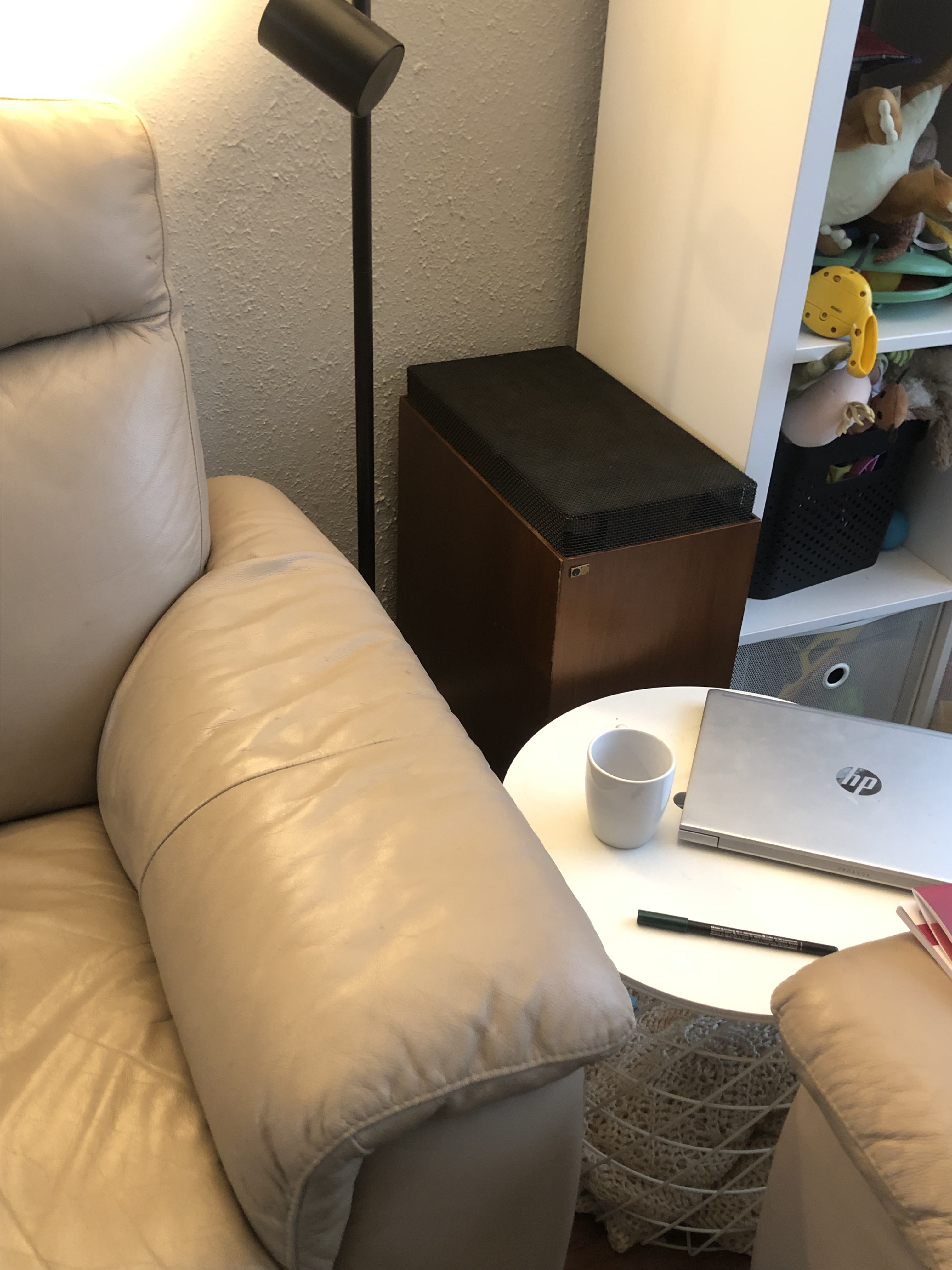

I couldn't leave them sitting there. So I took them home with me and cleaned them up. They cleaned up quite nicely actually, so I ordered some female DIN-plugs, and once they arrived I hooked the old Sonab's up to my current Marantz amplifier.
And whaddaya know: Whatever treble-distortion was there 20 years is gone. All speakers play (the woofer and all 4 tweeters), the sound feels lively and a tad on the bright side but they do sound good, and there is not a hint of distortion. Not a hint.
Is it my older ears being less sensitive? Is it that the problem 20 years ago was whatever amplifier I was using then (I think it was a late 80's Sony TA-F100?...). Did the Sonab's magically fix themselves by sitting stored away for 18 years?
I have no clue. All I know is that they sound good.
And so I'm happy to report my dad's old Sonab's have found a permanent place in my living room. They are now in use as the rear channel for my surround setup, and let me tell you; Carlsson's ortho-acoustical approcach really works amazingly well as a rear channel setup.
Before the Sonab's I ran bookshelf-speakers on stands on either side of the sofa as my rears, and while it sounded fine, you could definitely tell the rear sound was coming from two 'hot-spots' on either side of the sofa.
But now when watching a movie, the entire wall behind the sofa comes to live. It's hard to properly explain, but you can hear the sound next to and behind you without being able to tell exactly where the speaker is placed. These speakers make a ton of sense as a rear-channel!
I'm thrilled I kept them and stored them, and I'm happy my dad's old speakers are playing once again. Plus, they have a high WAF-factor for being so unnoticeable. The veneer on the Sonab's coincidentally has nearly the same color as my flooring and they just kinda...blend in.
This story ended well
